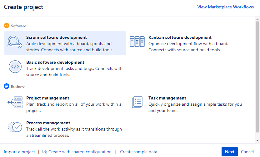

Jira Create Project
Jira Create Project plugin step is designed to create a software or business project in an instance of JIRA software.
The project types seen in the screenshot below can also be chosen in the plugin options as described in the Input Tab table below.

Project type
Provide a project type. The list of project types can be populated using the Get button described below.
4
Button: Get
Clicking on this button brings up a list of project types (viz. software, ops, service_desk, business).
5
Project Template Key
Select a valid project Template Key based on the type of project selected. The list of Project Template Keys can be populated using the Get button described below.
6
Button: Get
Clicking on this button brings up a list of project Template Keys as below,
  1. com.pyxis.greenhopper.jira:gh-scrum-template
  2. com.pyxis.greenhopper.jira:gh-kanban-template
  3. com.pyxis.greenhopper.jira:basic-software-development-template
  4. com.atlassian.jira-core-project-templates:jira-core-project-management
  5. com.atlassian.jira-core-project-templates:jira-core-task-management
  6. com.atlassian.jira-core-project-templates:jira-core-process-management
