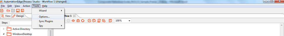

Setup:
Process Studio DesktopSpy is used to get many of the configuration parameters of Desktop plugin steps. To be able to use DesktopSpy we need to configure Process Studio Options Desktop SPY Port and Desktop Runtime Port. This is shown in the snapshots below.
  1. In Process Studio go to Tools menu and Options sub-menu.

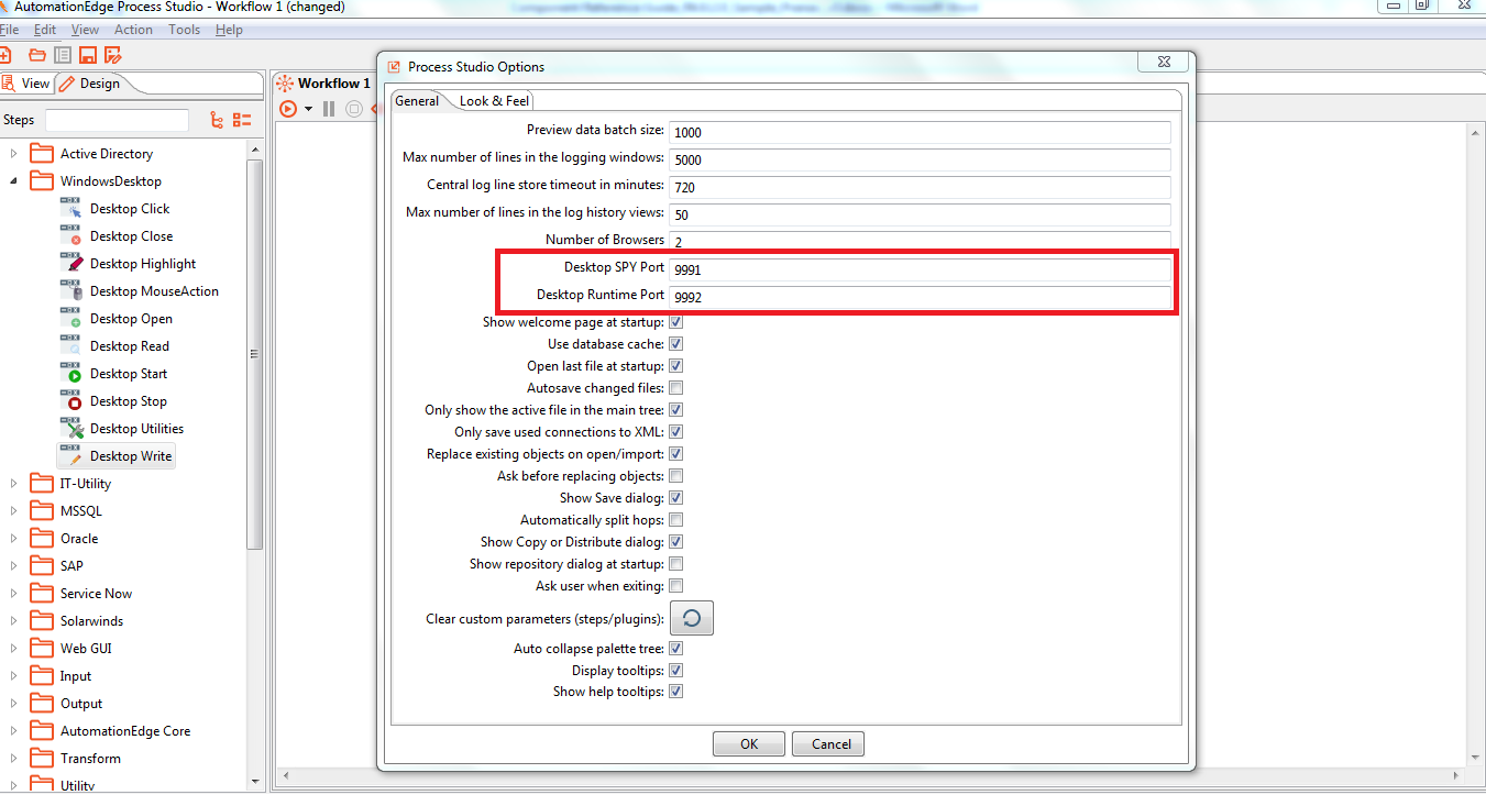

  1. Set or change Desktop SPY Port and Desktop Runtime Port if required or leave it to the default values.
  1. You are now ready to start using DesktopSpy with Desktop Plugins.
