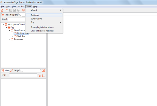

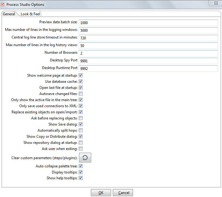

DesktopSpy is used to get many of the configuration parameters of Desktop plugin steps. To be able to use DesktopSpy we need to configure Process Studio Options Desktop Spy Port and Desktop Runtime Port. This is shown in the snapshots below.
  1. In Process Studio go to Tools menu and click on Options...
  1. Set or change Desktop Spy Port and Desktop Runtime Port if required or leave it to the default values.

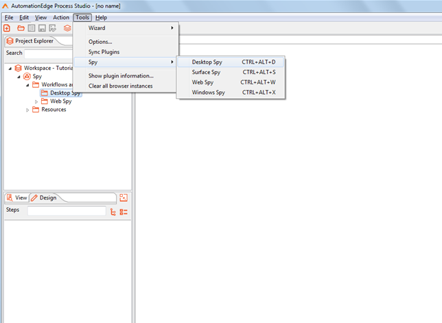

  1. To launch Web Spy go to Tools menu and click SpyDesktop Spy sub-menu.

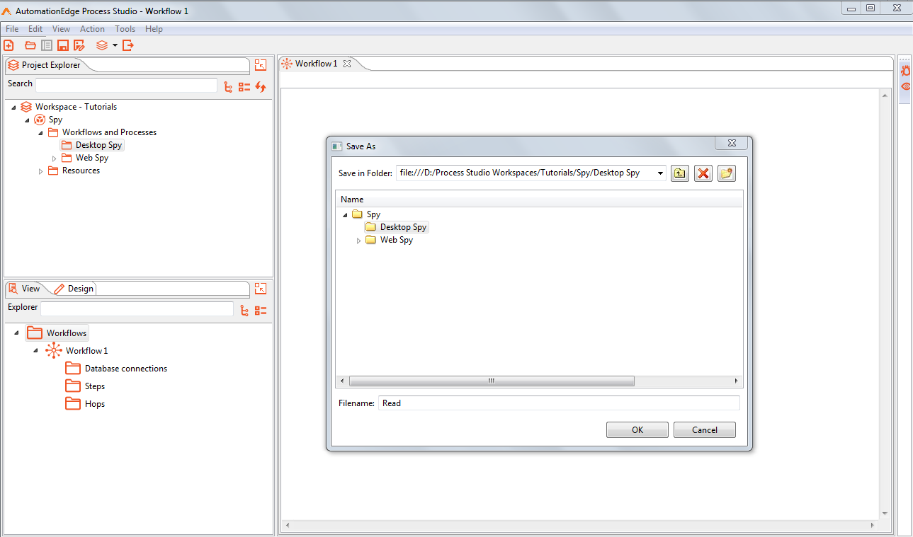

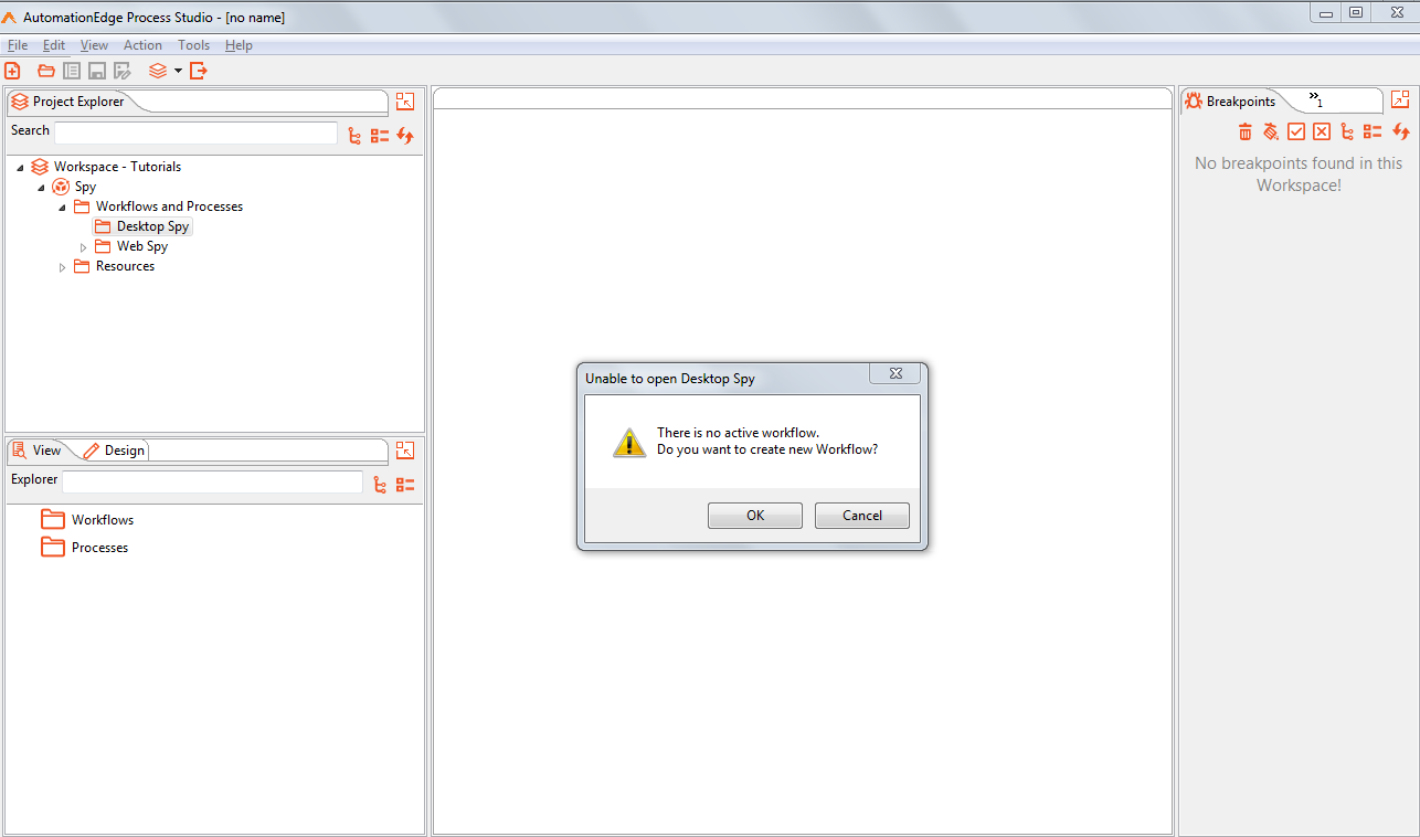

  1. If there is no active workflow a warning pop-up is shown. Click OK to create a new Workflow.
  1. Name the workflow Read.

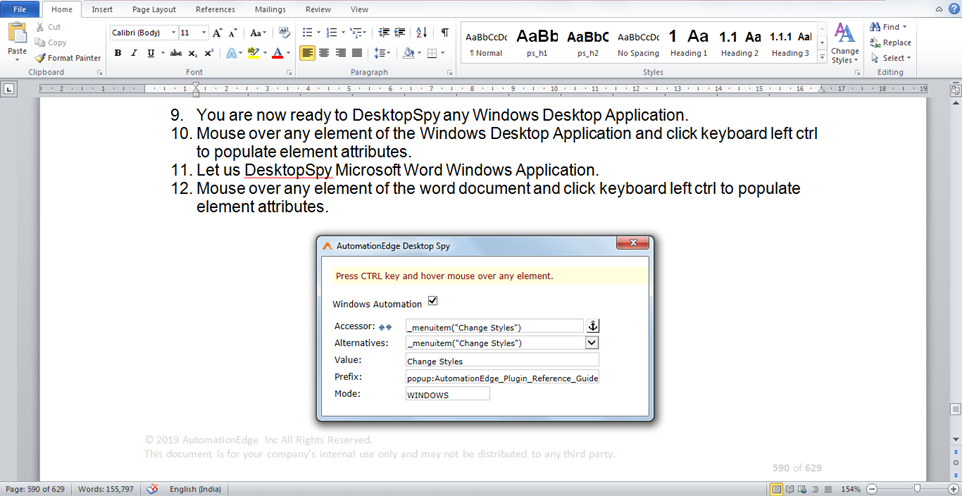

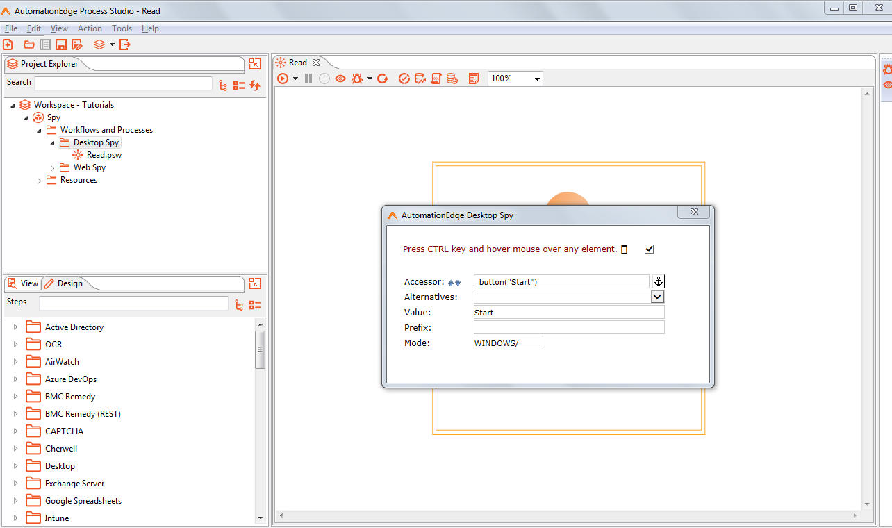

  2. Mouse over any element of the Windows Desktop Application or Java Applet and click keyboard left ctrl to populate element attributes.
  3. Let us DesktopSpy Microsoft Word Windows Application.
  4. Mouse over any element of the word document and click keyboard left ctrl to populate element attributes.
  5.   |
    For Example mouse over Change Styles and click keyboard left ctrl to populate values on DesktopSpy as shown below.

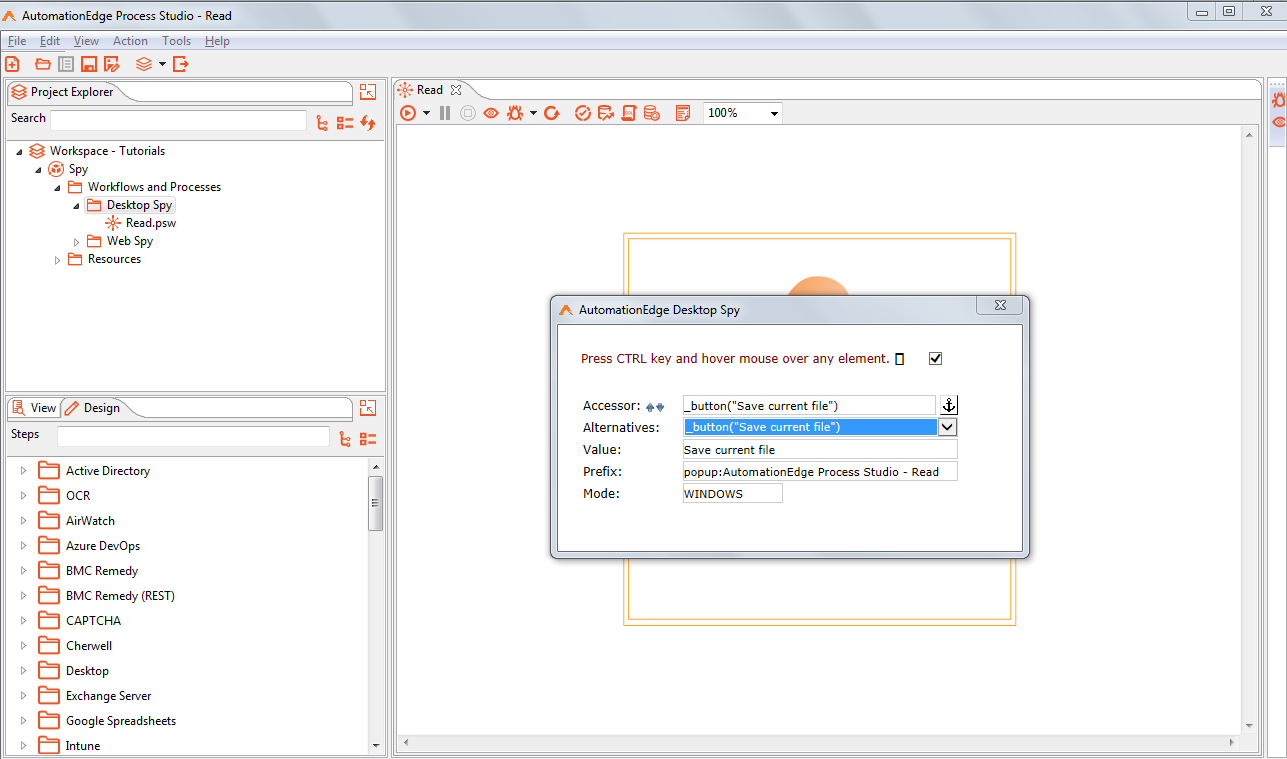

  1. In the following example Mouse over is done on save icon.

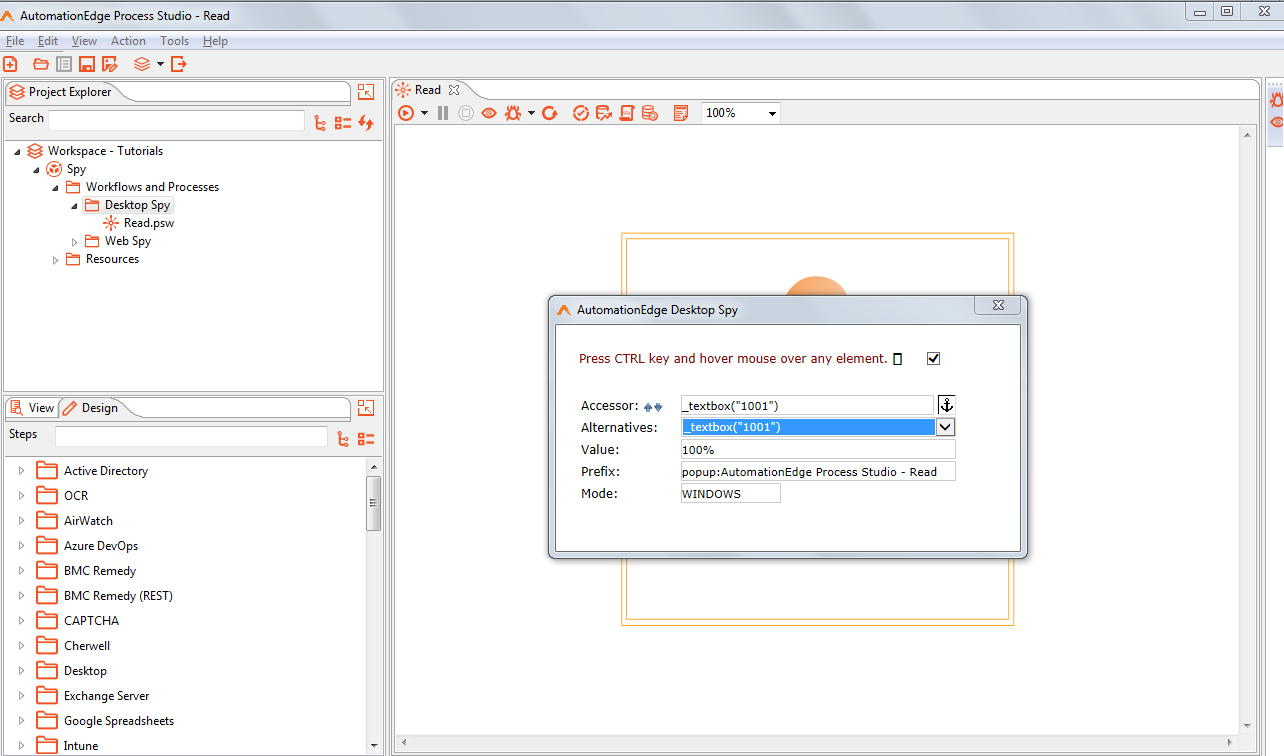

  1. The values of Accessor, Alternatives or Prefix can be used in plugin steps as required.
  2. We can also select Accessor Alternatives from drop down as shown below.
  1. The Value field in Desktop Spy shows the shows predicted output Value/Text of Desktop Read plugin
    . The value of the text box highlighted in red is seen in the image below.
