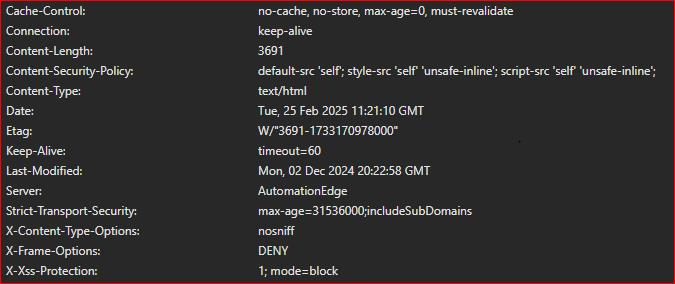

Validation
  1. Restart the AE application
  2. Open browser → Press F12
  3. Go to Network tab → Response Headers
  4. Verify XSS-related headers are present
