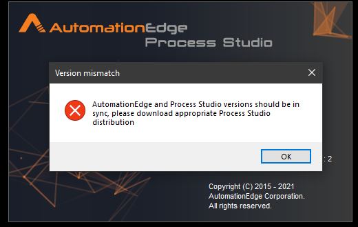

Issue:
Unable to Open Process Studio gives the error as below:
This issue occurs when the Process Studio version is not same as AutomationEdge Server version.
How to Reproduce:
Try Opening Process Studio version 6.0.0 when the T3 is on AE version 6.1.0
Resolution:
- Try to Open the Old Version Process Studio and De-Register
- Download the latest Process Studio version from the portal, T3 / OnDemand.
- Open CMD on the same folder process studio/bin and open process-studio.bat file and check.
- Log in to your account with the same Credentials.
- This should resolve your issue.
