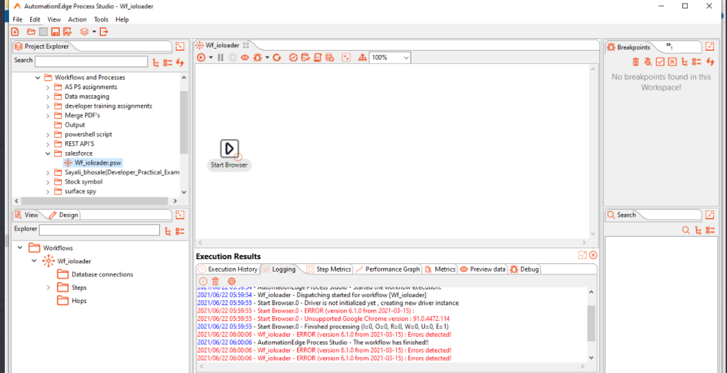

Unsupported Google Chrome version 91.0.4472.77
Error:
Solution:
- The Chrome91 Web-GUI jar is available on EPD
-For AE version Below 5.0
- Download  web-gui-4.0.1.13-complete.jar  from the AutomationEdge Plugin section. =>  WEBGUI - AE Below 5.0 and upload to your server and sync the plugins in Process-Studio .
-For AE version 5.0 to 5.6
- Download  web-gui-1.15-complete.jar  from the AutomationEdge Plugin section. => WEBGUI - AE_5.0 to 5.6.* and upload to your server and sync the plugins in Process-Studio.
-For AE version 6.0 & above
- Download  web-gui-2.1-complete.jar  from the AutomationEdge Plugin section. => WEBGUI - AE_6.0 & above  and upload to your server and sync the plugins in Process-Studio . A lso download  ChromeDrivers for AE6.0  from  the AutomationEdge Plugin section =>ChromeDrivers.
