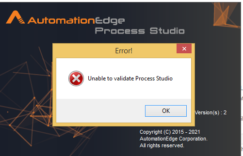

Unable to validate Process Studio
Error:
Steps for resolution:
1.Open below PS folder location on your machine.
\process-studio-6.0.0\process-studio-6.0.0\conf
2.Copy the three files(.licconf,.regconf,.tmp) from the conf folder and take backup into another folder.
3.Delete that three files(.licconf,.regconf,.tmp) from the conf folder.
4.Start the "Process Studio" and enter the credentials.
5.Then will get one error "Process studio is already registered for  "XYZ" user".
5.Please copy the .regconf file from the backup folder and paste it into the conf folder again
6.Restart the "Process studio" & try to connect.
