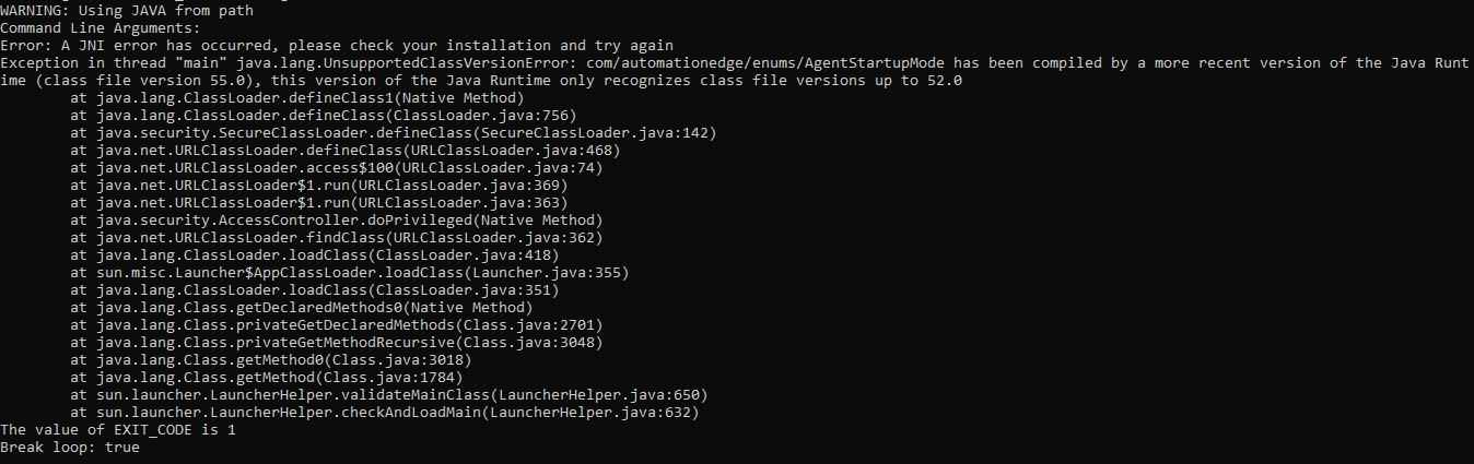

While starting the agent we get the error below:
Error: JNI error has occurred, please check your installation and try again
Exception in thread "main" java.lang.UnsupportedClassVersionError: com/automationedge/enums/AgentStartupmode has been compiled by a more recent version of the Java Runtime (class file version 55.0), this version of the Java Runtime only recognizes class file versions up to 52.0

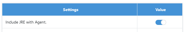

You can reproduce this issue by Going to your server > Agent > Agent Settings and Disable the Include JRE with Agent.
Resolution:
To resolve the issue, you can go to the below path:
- Agent > Agent Settings and Enable the Include JRE with Agent.
- Download a new agent and start the agent.
