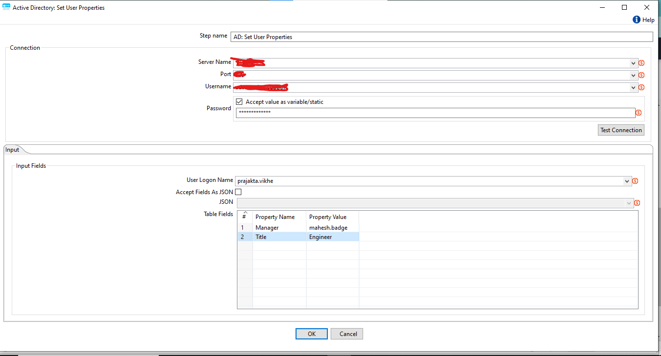

AD: Set User Properties : Not able to set below properties
1. Pager
2. Job Title
3. Manager
4. Member Of - Not able to use

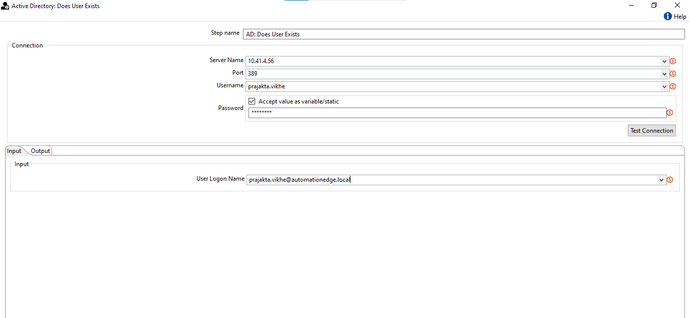

AD: Does User Exist : If a user already exists, still getting result as False.
1. Pager:
You can use active diectory-3.15-SANPSHOT-Complete Jar file.
2. Job Title:
In latest version job title property is updated as Title.
3.Manger :
We can only set the manager name because it is not possible to set email id or employee Id along with manager name.
4. Member Of:
You can use AD: Add To Group plugin step.
AD: Does User Exist
You need to pass user principle name or full name in User Logon Name.
