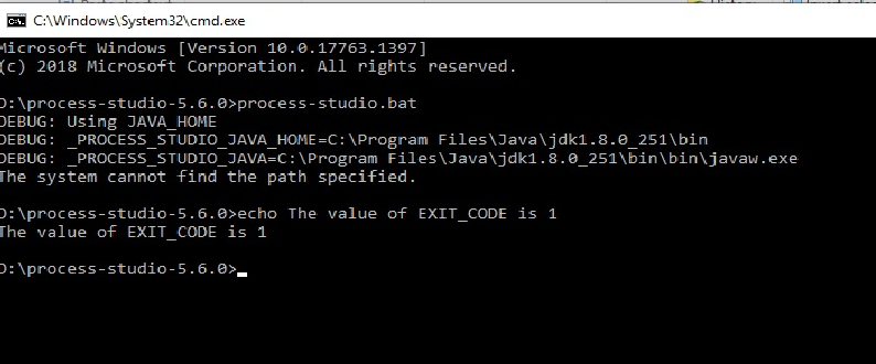

Issue: Unable to start Process studio 5.6.0 instance.
Getting an error message. When clicking on the Process-Studio.exe file Process Studio is not opening.
Enclosed is the screenshot when running the process-studio.bat file on cmd.
Solution: After setting the environment variables, the issue has resolved.
Please check the environment variables are correctly set or not.
