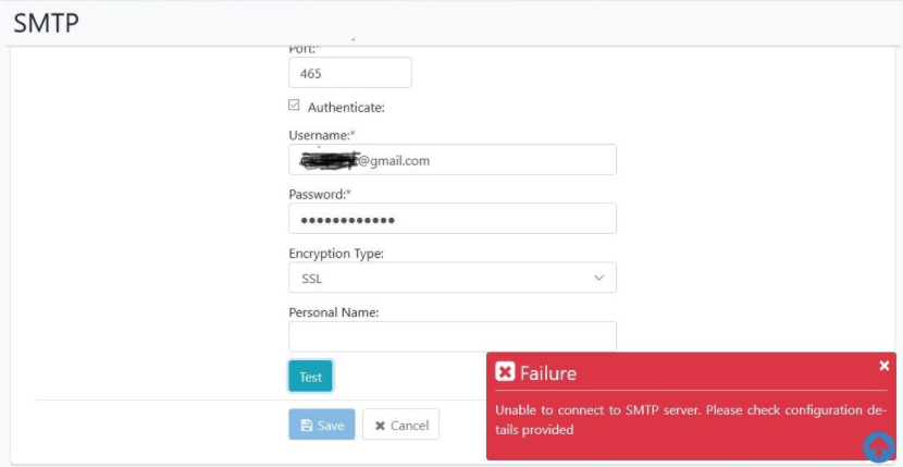

Unable to configure SMTP : SMTP connection failed
Error  :
Error in AutomationEdge Logs :
2021-02-02 16:50:10 IST (+05:30) https-jsse-nio-443-exec-42 ERROR AEEmailServiceImpl:466 - SMTP connection failed
org.springframework.mail.MailAuthenticationException: Authentication failed; nested exception is javax.mail.AuthenticationFailedException.
