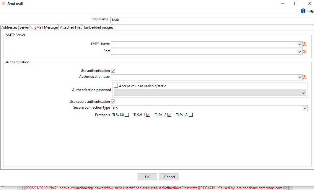

Issue:
Error Details - Error in step ( SM_SendMail_Success_2 ) : Can not send mail! 421 4.7.66 TLS 1.0 and 1.1 are not supported. Please upgrade/update your client to support TLS 1.2. Visit https://aka.ms/smtp_auth_tls. [SN7PR04CA0020.namprd04.prod.outlook.com]
Solution:
-  Enable the TLS protocols as per the requirement.
