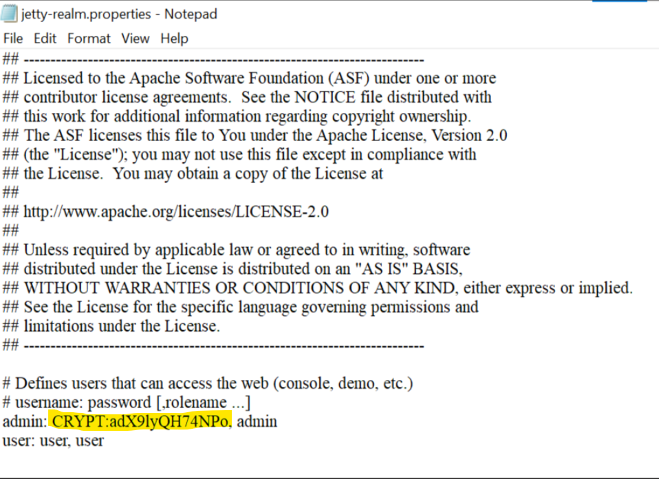

4) Open the jetty-realm properties file from ActiveMQ conf directory.
5)Below lines are the last line of the jetty-realm.properties file(please find the below screenshot for your reference).
    admin - CRYPT:Paste the encrypted password here,admin
