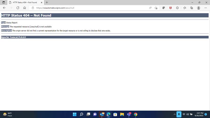

For SAML 2.0 in the sso configuration, clients mostly facing issue for logout page. Request is re-directing to null page instead of logout.jsp
This issue occurs till 7.3v. This will be fixed in Upcoming upgrade of 7.4.
Error:
HTTP status 404- page not found
