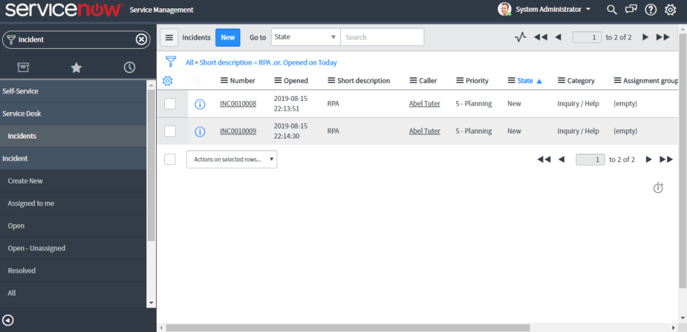

The following screenshot shows that sys_id can be copied by right clicking  on a particular record.
Alternatively create filters in SNOW UI and copy Criteria Query from the UI. This is especially useful for complex query criteria with one or more AND, OR criteria.
The following is a screen shot of the Incident Application. You can see the filter sign on top of the column headings. It shoes the filter Active=True has been applied on All incidents.
You may right click on the filter and click Copy query to copy the Criteria Query.
You may paste this as Criteria Query in the plugin step.
  1. active=true
You can now see the filtered list with filter applied: Short_description=RPA or Opened Today.
Right click on the filter and click Copy query.
The Criteria query is as follows:
short_description=RPA^ORopened_atONToday@javascript:gs.be
ginningOfToday()@javascript:gs.endOfToday()
You may now use it in the Plugin step.

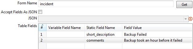

Tabular fields:
5
Variable Field Name
This is an optional field. Choose a field in input stream from drop down list or provide a user or system defined variable.
6
Static Field Name
On click of this column field, it opens a dialog with the list of available form fields of the provided Form Name.
The name of the fields to be inserted should be selected. Multiple fields can be selected from the list displayed on click. The selected field’s values below will be inserted in the record.
Validation: The plugin validates field names from remedy server.
If ‘Static Field Name’ and ‘Variable Field Name’, both are provided in the same row in ‘Table Fields’ then ‘Static Field Name’ will be considered to build the JSON to insert a record.
7
Field Value
Provide field values to be inserted in the corresponding chosen fields.
Following, is a sample snapshot of input tab with Table Fields with Static Field Name.
Following, is a sample snapshot of input tab with Table Fields with Variable Field Name.
If the selected Field Name is mapped with any Lookup List on the backend then, in that case, it will accept only valid mapped values in the Field Value and the ticket will be created. But if an invalid value is provided to such Fields then the ticket will take the default value mapped with that Field on the backend.

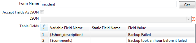

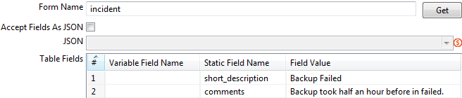

Table Fields:
8
Variable Field Name
9
Static Field Name
10
Field Value
Provide field values to be updated in the corresponding chosen fields.

3
Table Sys ID
The Sys ID of the record to which an attachment needs to be uploaded.
