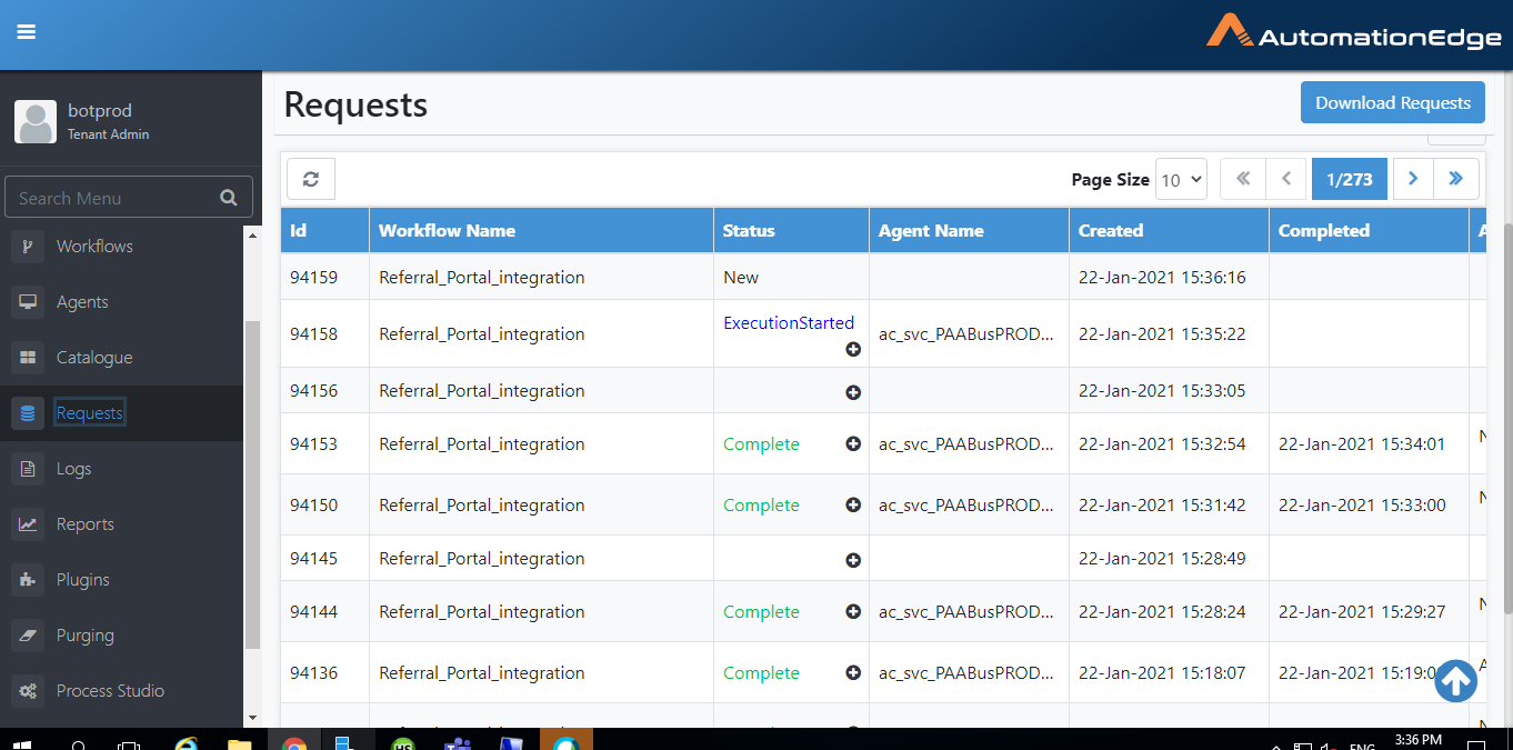

Issue Details:
On the AutomationEdge server, the request status is not getting updated and it shows blank
Issue Description:
- The request for which the status is Blank, is in RETRY status. The request goes into the RETRY status when the request didn't get the credentials to execute that request.
- The request gets stored in the ActiveMQ queue and it starts execution once it gets the credentials for execution. The request status gets automatically changed once the execution of the request gets started.
- Here the Credentials means, the Credentials in the CredentialPool. The workflow must have configured with the CPool.
- This is a Known issue till the 5.6.2 version and it gets fixed in AE 6.0.
