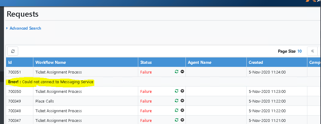

Error in Request:
Could not connect to messaging service
Issue to Reproduce:
- Stop the ActiveMQ service and submit a request from Catalog.
Solution:
- Please check the ActiveMQ service, It might in a stopped state. Start the ActiveMQ service and check.
