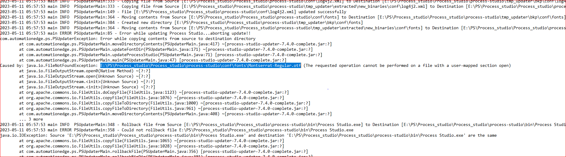

Issue:
Process studio is not running
Error:
Cause:
That Font file was locked by JVM and during update updater was not able to update Font Directory
And because of that it started rollbacking Process Studio upgrade process
During rollback also it faced issue and because of that rest of the directories were not rollbacked and that's why Lib directory was not resorted with original lib files
Solution:
Delete the fonts folder from process-studio\conf directory.
