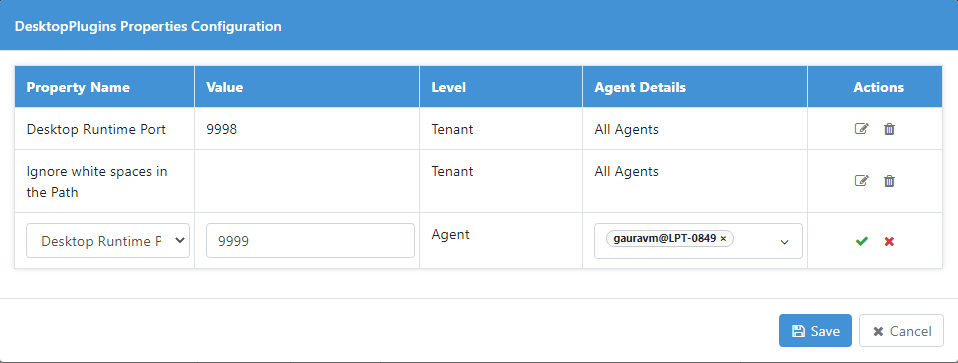

Kindly add another port using the steps below:
On server Go to > Plugin > DesktopPlugins > Click on Configuration properties  and the add a Property value and specify to which agent it need to set the port, as below:
