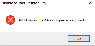

.NET Framework 4.6 or higher is required !
ERROR:
Resolution:
1. Open Process studio system path location on your system
\process-studio-5.6.0\psplugins\DesktopPlugins\.desk
2.Edit the .desk file and change below parameter.
ae.check_.NET_version=false
