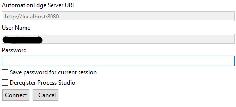

Issue
While opening the process studio, we get the below screen where the the text fields are greyed out with incorrect URL path.
Here https://ondemand.automationedge.com/  Changes to http://localhost:8080/
