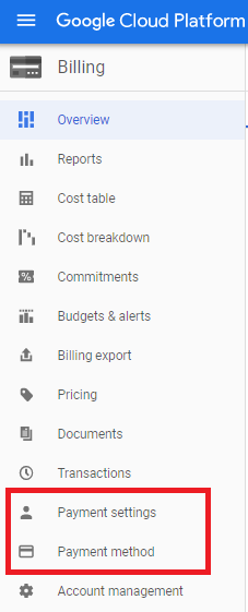

  1. Fill the details under the following as seen in the snapshot below,
Billing -> Payment Settings and Billing -> Payment Method for API Key to work.
