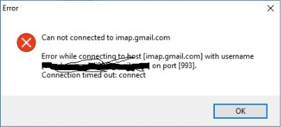

Issue:
In Email Message Input plugin, Unable to connect to to IMAP server while testing connection, as it shows connection timed out as below:
How to Reproduce:
You can turn on/Enable the Antivirus, Restart the Process Studio to reproduce this issue.
Resolution:
There are different cause for this issue, so kindly check the details below:
-      There's a firewall or anti-virus program intercepting your request, you can disable for the time being
-      You can also try to enable a less secure app on Gmail on Gmail setting.
-      Also if your organization restricts any rule to send an email, please contact your IT team.
