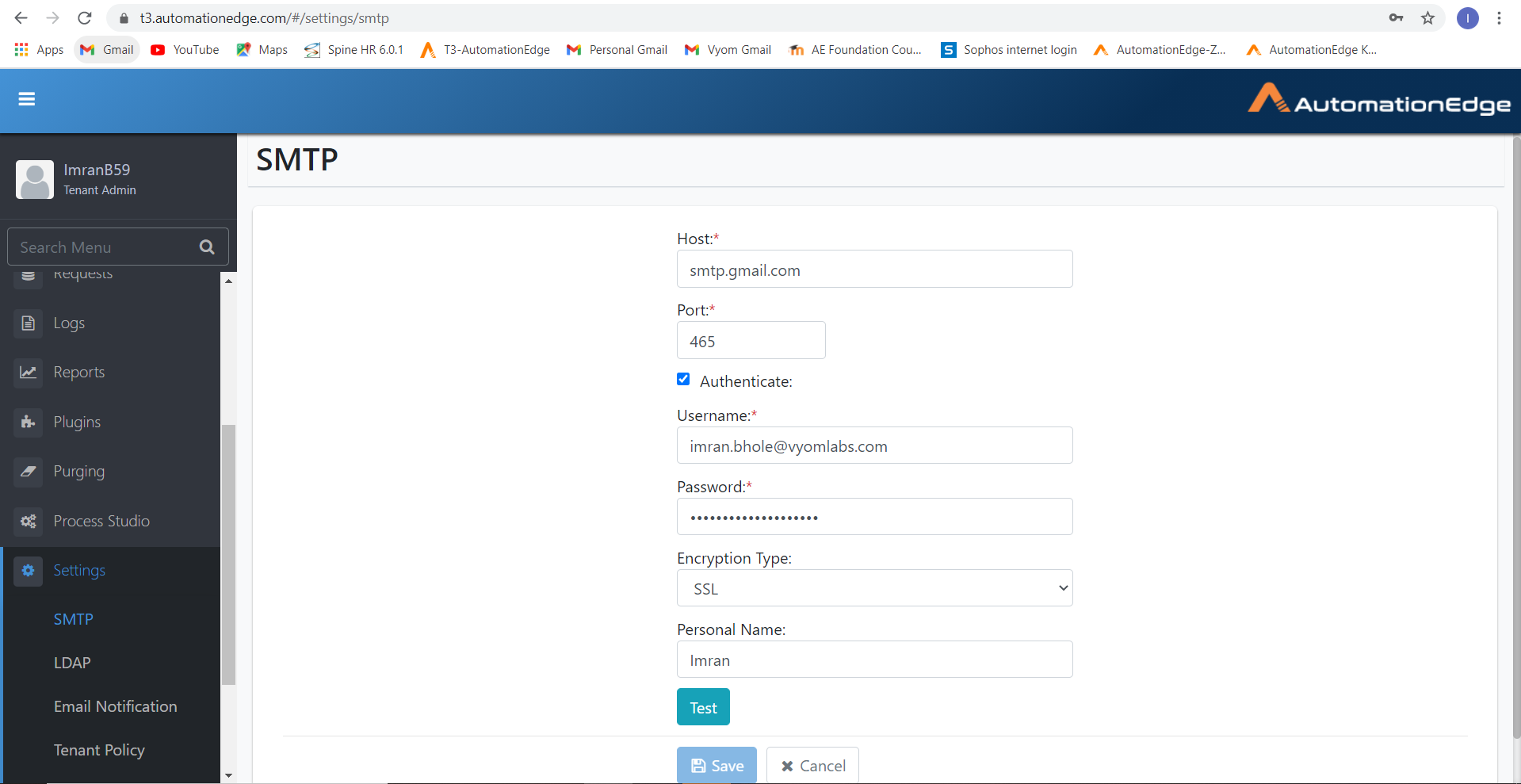

Please see the below screenshot of SMTP setting in AutomationEdge Portal.
