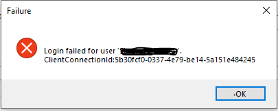

Error :
 Login failed for user '*******'. ClientConnectionId:5b30fcf0-0337-4e79-be14-5a151e484245.
