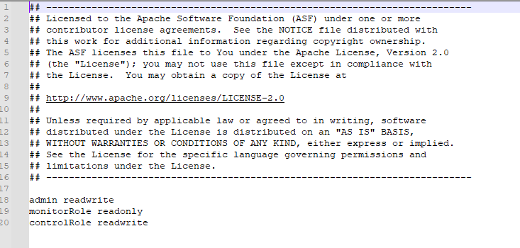

Step 3:  Create access and password files
conf/jmx.access:
# The "monitorRole" role has readonly access.
# The "controlRole" role has readwrite access.
monitorRole readonly
controlRole readwrite
jms.access file looks like:

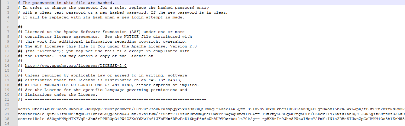

conf/jmx.password:
# The "monitorRole" role has password "abc123".
# The "controlRole" role has password "abcd1234".
monitorRole abc123
controlRole abcd1234
Jmx.password file looks like:
-Password will get encrypted automatically once you start the service. Initially you have to type in plain text.

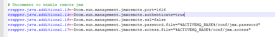

Step 4:  Modify the Wrapper.conf in ..\ActiveMQ _home\bin\win64 to enable the Java 1.5+ JMX connector- for ActiveMQ is installed as service
# Uncomment to enable remote Jmx
wrapper.java.additional.13=-Dcom.sun.management.jmxremote.port=1616
wrapper.java.additional.14=-Dcom.sun.management.jmxremote.authenticate=true
wrapper.java.additional.15=-Dcom.sun.management.jmxremote.ssl=false
wrapper.java.additional.16=-Dcom.sun.management.jmxremote.password.file="%ACTIVEMQ_BASE%/conf/jmx.password"
wrapper.java.additional.17=-Dcom.sun.management.jmxremote.access.file="%ACTIVEMQ_BASE%/conf/jmx.access"
After changes file looks like:

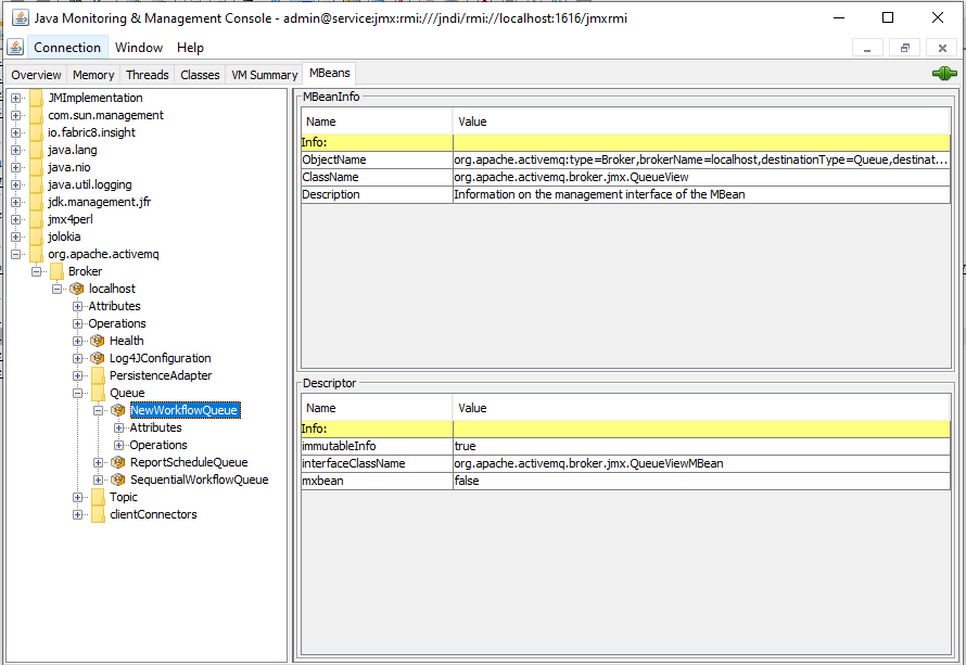

Step 5:   Start ActiveMQ

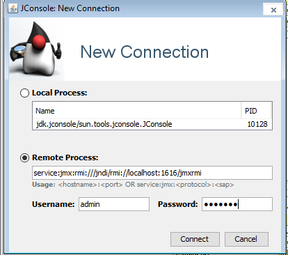

Step 6:  You should be able to connect to JMX on the JMX URL
service:jmx:rmi:///jndi/rmi://<your hostname>:1616/jmxrmi
Open JConsole and enter the URL, Username and Password:
