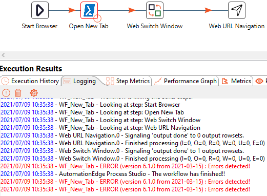

Issue:
- PowerShell was not working and showing error with no detailed information.
How to reproduce:

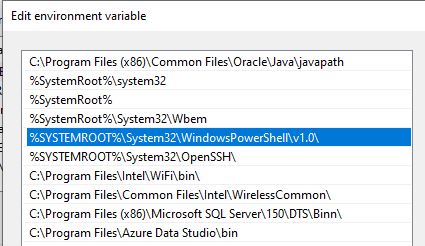

You can reproduce this issue by removing the Powershell Path from Environment Variable in PATH.
Resolution:
- Normally this error comes when the path was not found for Powershell in Environment variable which in turn caused the error in workflow execution.
- After setting the path in Environment Variable In PATH, the workflow works perfectly fine.
NOTE : You can check the path for the variable and set it accordingly.
