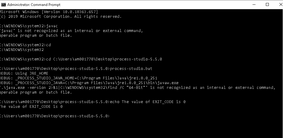

Issue: When trying to open the process studio, faced the below error message.
Solution: Please follow the below steps. Also, find the below screenshot for details.
1. Open the "D:\process-studio-5.5\libsw\", in that you found 2 folders i.e win64 & win32
2.  Copy the 64 swt present under the win64 folder to win the 32-bit folder.
3. Before pasting the 64 swt, please take the backup of 32-bit swt.
4. Try to start the process studio.
