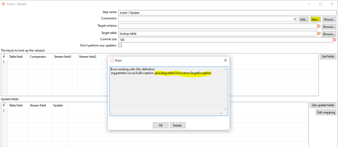

ERROR:
org.pentaho.ui.xul.xulexception java.lang.reflect.invocationtargetexception
Resolution:
This issue occurs when you're using Java version 9 or above, so make sure Java Runtime Environment (JRE) 1.8 or later version is installed on your machine.
You must set the JRE_HOME environment variable to point to the JRE installation directory.
