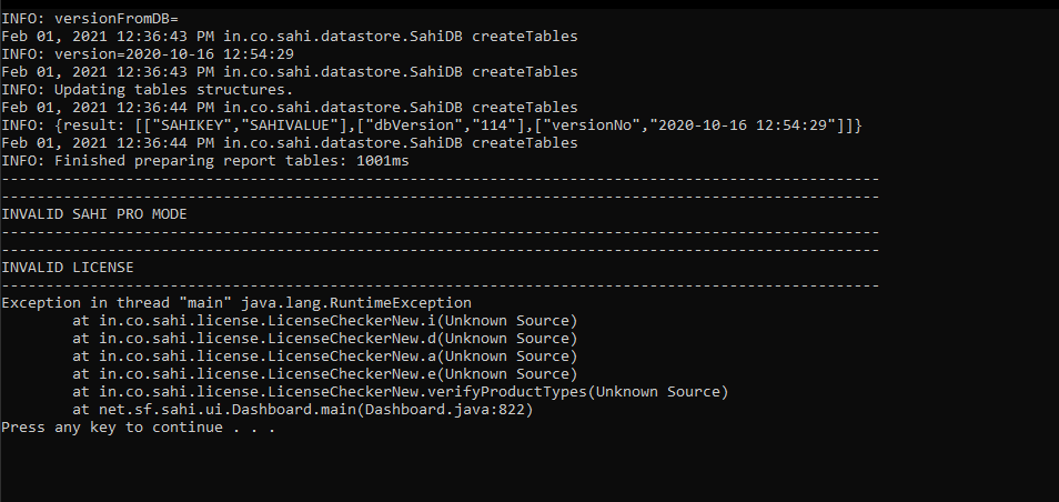

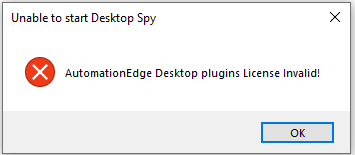

Issue:
When using Desktop Spy in process studio we get the error as below:
While starting the start_dashboard.bat
How to Reproduce:
To reproduce this issue you need add the below line in the path :
"process-studio-6.0.0\psplugins\DesktopPlugins\desktop-engine\userdata\config\userdata.properties" file
sahi.runner=true
Resolution:
In "process-studio-6.0.0\psplugins\DesktopPlugins\desktop-engine\userdata\config\userdata.properties" file you can comment the last line as below:
#sahi.runner=true
