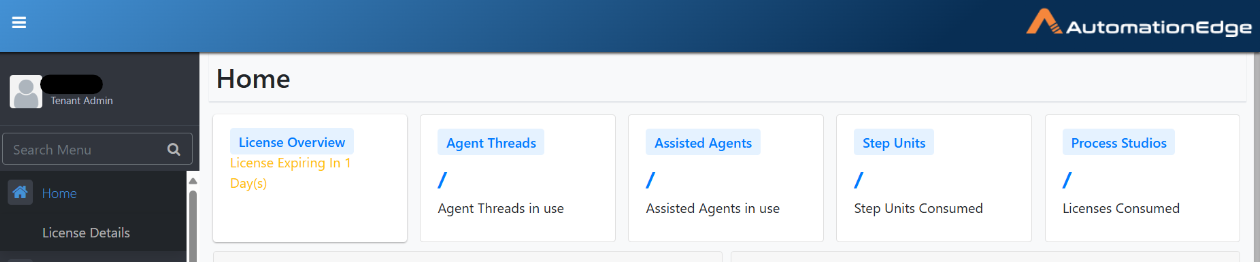

On AutomationEdge portal it is showing license expire in 1 day, however the license will expiry date is future dated.
