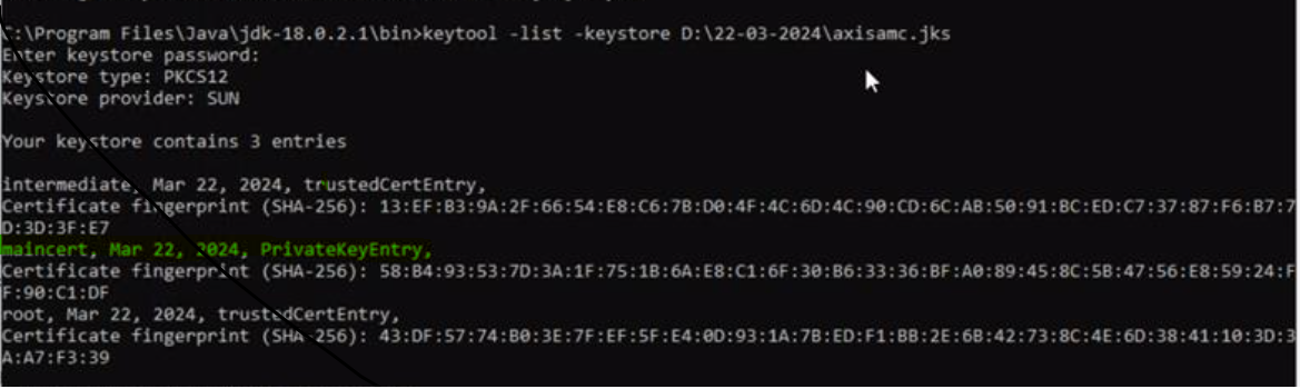

Step 2: Verify Certificate and Private Key in Keystore
Check the contents of the keystore:
keytool -list -keystore your_JKS.jks
Warning
Important:
If the PrivateKeyEntry is missing, you must first import the private key into your main certificate, then re-import that updated certificate into your JKS file.
