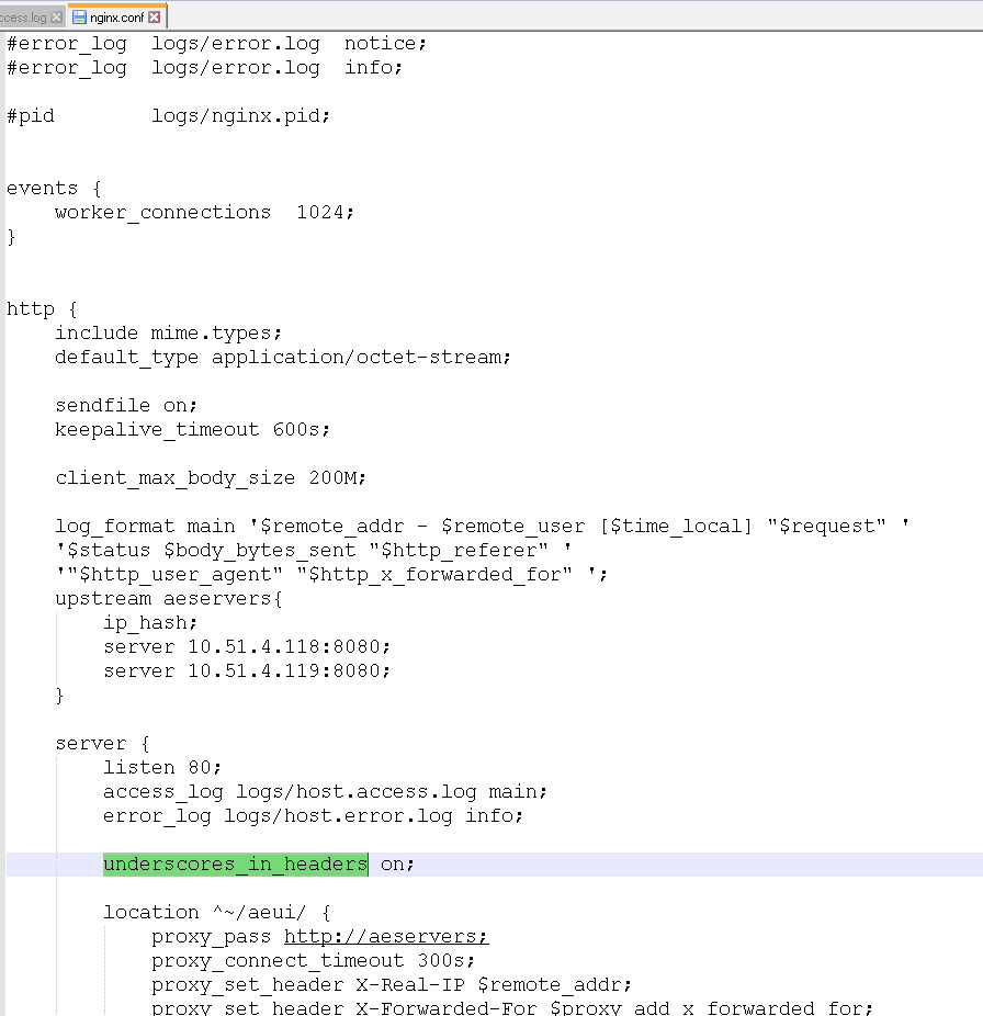

Solution:
A solution to this issue is to add following directive in nginx configuration: underscores_in_headers on;
