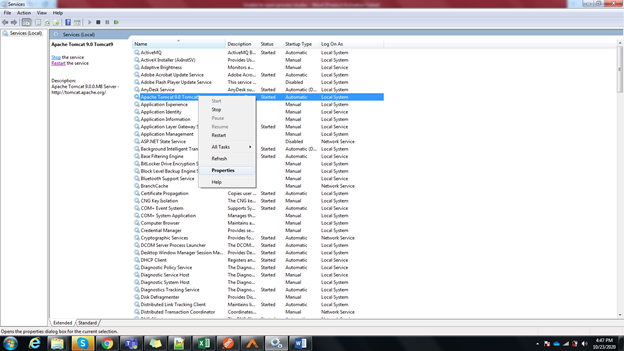

      - Open the Services.msc from the computer
      - Select the Apache-Tomcat-Service, right-click and select properties
      - Here you can find the Actual Tomcat Service Name
      - The tomcat service configuration is set on below 2 files present in apache-tomcat/bin folder
      - The *w.exe file is used for updating the service parameters like heap size etc.
      - Name of the *w.exe file has to match the service name, otherwise even if you make changes in the parameters, those do not take effect
Ex: If your tomcat service name is “abc” then you need to create a new file with the name “abcw.exe” and do the configuration changes in this file to take effect
