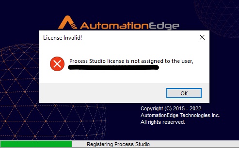

Issue:
When we start Process Studio, it shows the below error message:
How to reproduce:
Unassign license from AutomationEdge Portal<<Process Studio Tab<<Assign License
Resolution:
Please login to AEUI. Please follow the below steps.
- Go to the Process Studio (PS) Tab
- Assign license
- check box should be checked for your tenant user then restart the Process studio Application.
- Sync all plugin
- Tools  and Sync plugin
- After all the plugins are up to date you can use PS.
