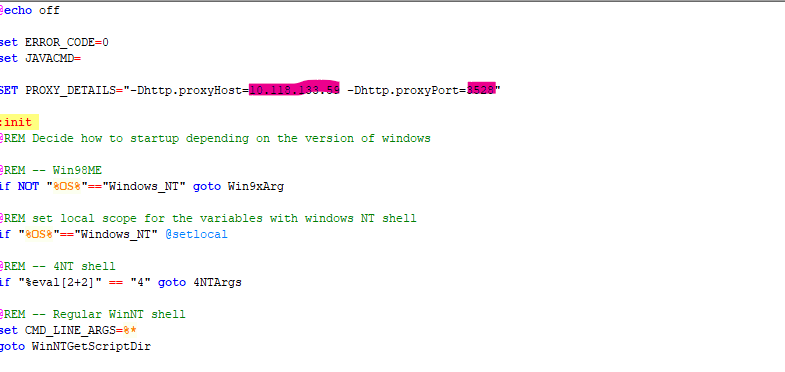

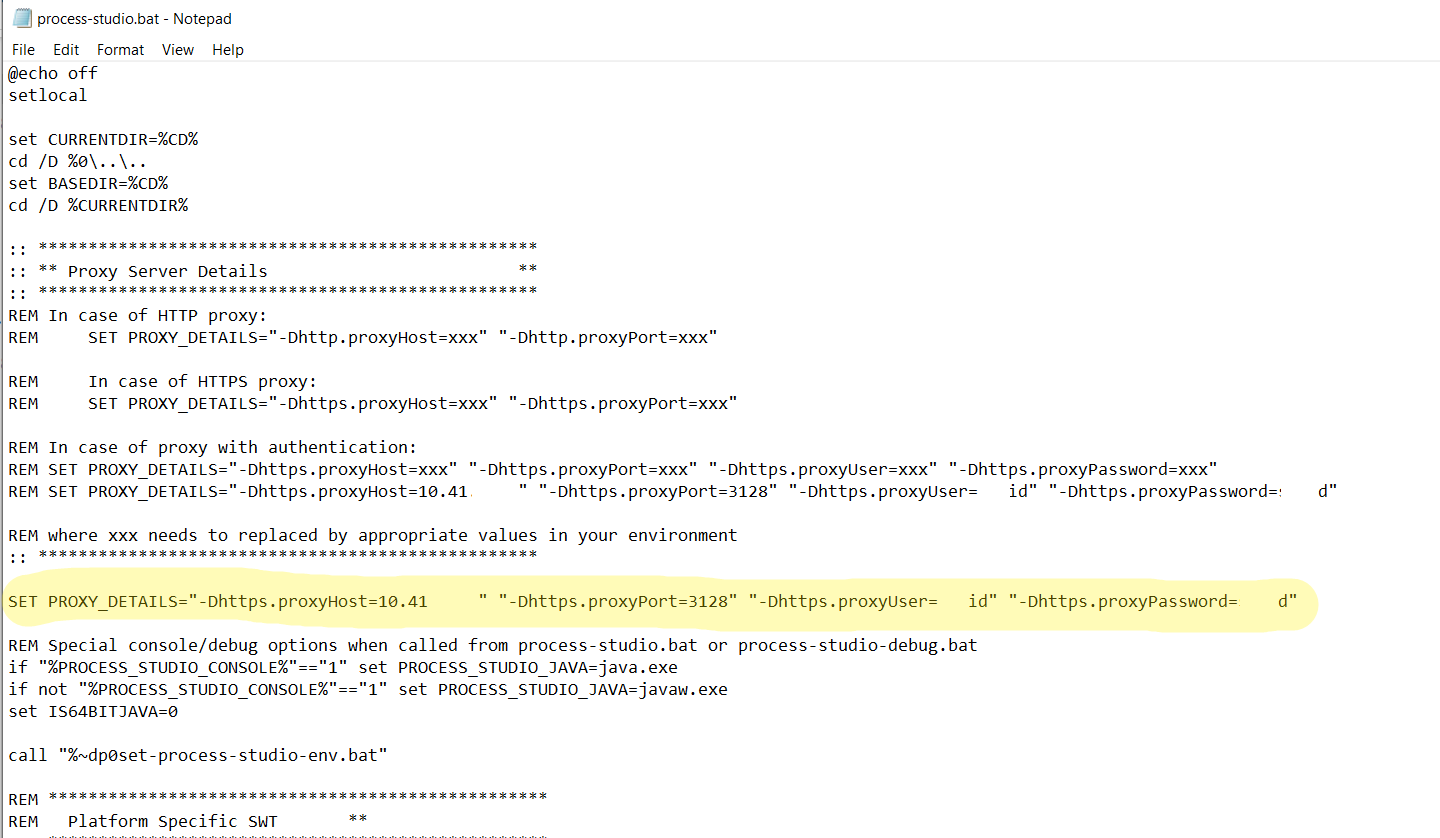

Please find details for how to add proxy in Process-studio folder:
- Please refer the screenshot to add proxy details in process-studio.bat file.

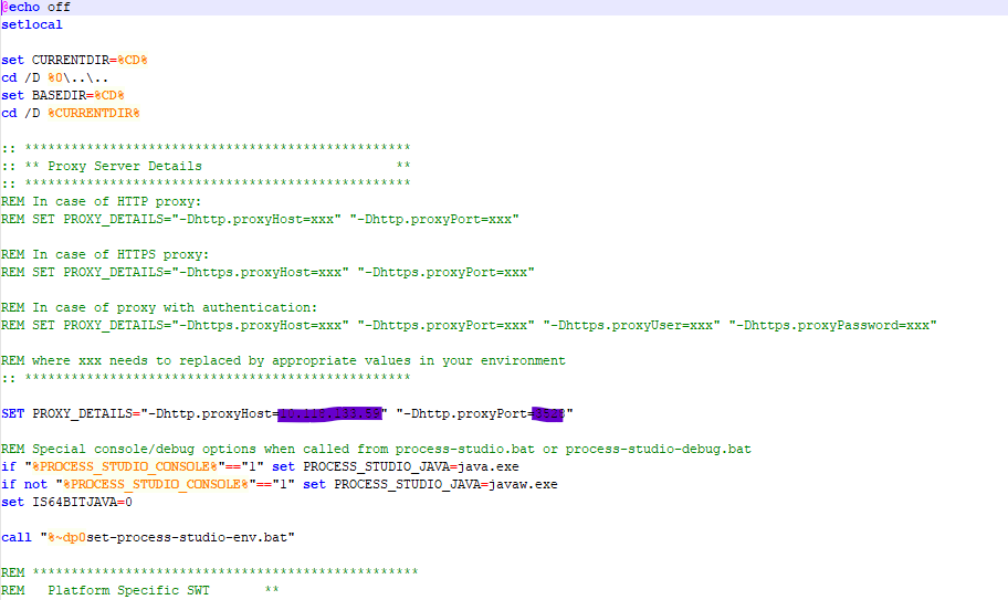

Please find details for how to add proxy in agent folder:
-Please refer the screenshot to add proxy details in agent startup.bat file
Quote
As per proxy http or https we have to make changes in batch file. Dhttps means (HTTPS) & Dhttp for (HTTP).
if it is not https we have to change -Dhttps to -Dhttp everywhere.
:: ** Proxy Server Details                         **
REM In case of HTTP proxy:
REM    SET PROXY_DETAILS="-Dhttp.proxyHost=xxx" "-Dhttp.proxyPort=xxx"
REM    In case of HTTPS proxy:
REM    SET PROXY_DETAILS="-Dhttps.proxyHost=xxx" "-Dhttps.proxyPort=xxx"
REM In case of proxy with authentication:
REM SET PROXY_DETAILS="-Dhttps.proxyHost=xxx" "-Dhttps.proxyPort=xxx" "-Dhttps.proxyUser=xxx" "-Dhttps.proxyPassword=xxx"
REM where xxx needs to replaced by appropriate values in your environment
