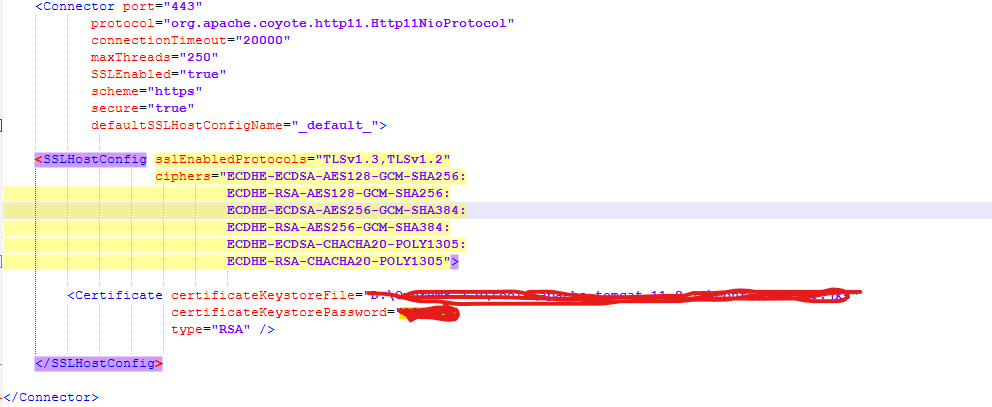

Solution:
– Add this cipher in the server.xml file.
      For reference, please follow the file path: (D:\Onprem8.2.0\tools\apache-tomcat-11.0.6\conf\server.xml)
<Connector port="443"
           protocol="org.apache.coyote.http11.Http11NioProtocol"
           connectionTimeout="20000"
           maxThreads="250"
           SSLEnabled="true"
           scheme="https"
           secure="true"
           defaultSSLHostConfigName="_default_">
    <SSLHostConfig sslEnabledProtocols="TLSv1.3,TLSv1.2"
                   ciphers="ECDHE-ECDSA-AES128-GCM-SHA256:
                            ECDHE-RSA-AES128-GCM-SHA256:
                            ECDHE-ECDSA-AES256-GCM-SHA384:
                            ECDHE-RSA-AES256-GCM-SHA384:
                            ECDHE-ECDSA-CHACHA20-POLY1305:
                            ECDHE-RSA-CHACHA20-POLY1305">
        <Certificate certificateKeystoreFile="D:\Onprem8.2.0\tools\apache-tomcat-11.0.18\conf\aeserver.jks"
                     certificateKeystorePassword="123456"
                     type="RSA" />
    </SSLHostConfig>
