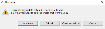

There are other scenarios while working with this step. You may use the Get Fields button above to fetch field Names. You may click on this button again for any reasons such as new fields in the workflow stream etc. In such a case if data is already present in the step a pop-up windows is displayed with four options as seen in the snapshot below.
You may choose to add only new rows, Add all rows again, Clear existing rows and add all rows or cancel Get Fields button.
