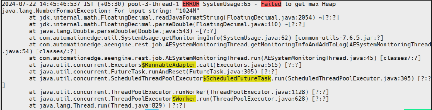

Error:
Failed to get the max Heap for Tomcat on Linux(Centos).
ERROR SystemUsage:65 - Failed to get max Heap
java.lang.NumberFormatException: For input string: "2048M".
