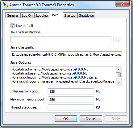

Steps To Reproduce:
- Double click on the tomcat9w.exe file from apache-tomcat/bin location
- Click on the JAVA tab and Check the Use Default option for the Java Virtual Machine option.
- Now start the tomcat service
Solution:
- Check the java version installed on the machine. Perform java -version on cmd to check
- Check the JAVA_HOME and JRE_HOME environment variable are pointing to the correct path or not
