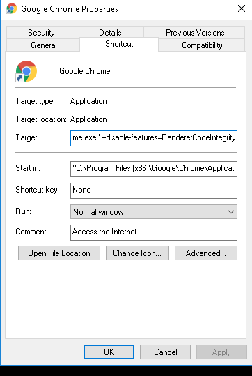

                  Please set --disable-features=RendererCodeIntegrity property in chrome properties.

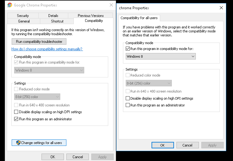

            Apply this change for all the user as shown in below screenshot
            Compatibility->Change settings for all users->Run this program in compatibility mode.
