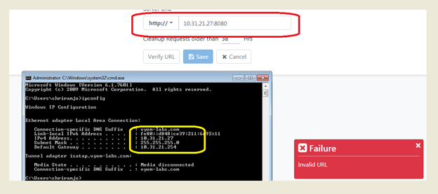

ERROR while login to AE using an on-prem instance.
Steps:
Please login with your IP address URL in the browser then try to configure IP?
For example http://10.31.21.27:8080/aeui
Whenever you will try to login with the localhost you will face this error instead of that please try with the IP address.
