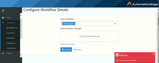

Error while importing workflow on AE server
ERROR:
C:\Program Files\AutomationEdge\aehome\AE_TEMP\ImportWflow_1597155801472\extracted\CMR_UPLOAD_MAIN.zip 2020-08-11 19:53:21 http-nio-8080-exec-10 ERROR
AEBaseRestController:51 - Error: com.automationedge.aeutil.exception. AECustomRuntimeException: Error importing workflow  com.automationedge.aeengine.rest.service.impl.AEPSWorkflowServiceImpl. importPSWorkflowStep1(AEPSWorkflowServiceImpl.java:1028) com.automationedge.aeengine.rest.service.impl.AEPSWorkflowServiceImpl. importPSWorkflow(AEPSWorkflowServiceImpl.java:1219) sun.reflect.NativeMethodAccessorImpl.invoke0(Native Method)
Step by step resolution:
This issue has been resolved successfully after adding "internal current directory" in the workflow path
