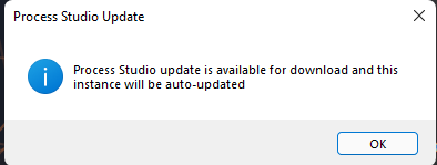

Sometimes we are not able to publish the workflow on Process Studio and when we do the Process Studio downloads and installs binary, it auto updates Process studio but doesn't reopen and gets a message as below:
