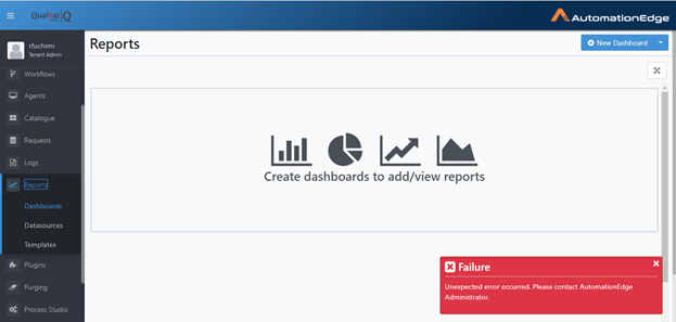

Error message in reports tab
Error:
This was the bug found by the engineering team
RCA:
When a user logs in to the AEUI and navigates to Reports >> Dashboard page, an HTTP call is made to the AE Server to get the list of - (1) dashboards which are created by logged in user and (2) dashboards of it’s tenant which have been marked as public.
In this tenant's case, a reporti dashboard named ""Teste"" was created by user ""uteste"" (user_record_id 7731) and it was marked as public.
Later, on 01-August-2020, this user ""uteste"" was deleted by another user ""rfuchimi"".
A user record got deleted successfully but dashboard records created by this user remained in the database.
​So the HTTP call being made from the AEUI was failing with the following error (from logs):
2020-08-12 00:26:29 IST (+05:30) https-jsse-nio-443-exec-204 DEBUG ReportRestController:397 - Request to get dashboards
2020-08-12 00:26:29 IST (+05:30) https-jsse-nio-443-exec-204 DEBUG GenericCRUDImpl:61 - No record found with id 7731 for entity com.automationedge.aeengine.rest.entity.User, returning null.
2020-08-12 00:26:29 IST (+05:30) https-jsse-nio-443-exec-204 ERROR AEBaseRestController:145 - Exception:  java.lang.NullPointerException: null
Fix/Solution:
The team has updated the dashboard record and removed its public access. We can also delete this record from the database table (not yet done)."
