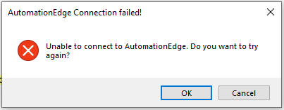

Issue:
While logging on to Process Studio we get the below error in Process Studio logs:
2021-03-17 11:53:58 main ERROR ProcessStudio:12005 - Error in registering Process Studio {}
org.apache.http.client.ClientProtocolException: null
How to reproduce:
Try entering Invalid URL in the URL field while Logging into Process Studio.
Resolution
This issue occurs when you enter incorrect URL in the URL field and you cannot log in to process studio.
Enter the correct URL or copy from the browser to work with Process Studio.
i.e. https://t3.automationedge.com/ or https://ondemand.automationedge.com/ or URL for your server.
