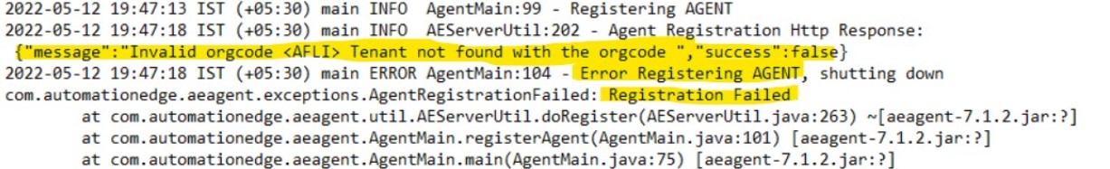

Issue:
We get the below error, Invalid Orgcode, while registering the agent on a machine.
This happens when you don't configure IP on your AE server and try to register an agent on another machine with Localhost URL.
How to Reproduce:
You can change the System configured IP on Automationedge back to localhost and download a new agent to register it on another machine.
Solution:
 Configure the Server URL in Sysadmin in Settings Tab with the system IP address where the AutomationEdge is installed. Then try to install new agent on new machine with the AEUI.
