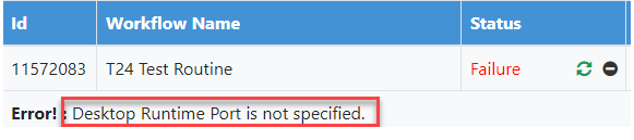

Desktop Runtime Port is not specified
ERROR:
Resolution:
In this case, you need to set the Desktop runtime port on the agent side as well.
To set the desktop runtime port you can refer to section 12.3 Plugin Properties Configuration in Automationedge user guide.
Please login to AE T3/OnDemand server with your tenant admin credentials and follow the instructions mentioned in the Automationedge user guide.
