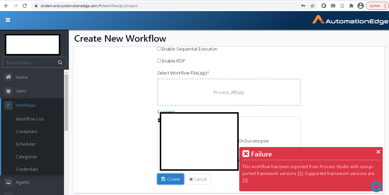

Defect in 6.0-Unable to Upload WF to PROD
ERROR:
Steps to Reproduce:
1.Please edit the existing workflow and try to update it.
2. Will face this issue same issue again.
Resolution:
This is a known issue. It has been documented in 6.0.0 which will get fixed in 6.1.0. At the moment,  follow the below steps and you will be able to import workflow in production.
  • Export workflow from AE UI UAT environment.
  • Import it in UAT process studio.  Save and Use Publish- update option and update the same workflow. (don't need to edit workflow)
  • Export updated workflow from UAT and Import in production.
