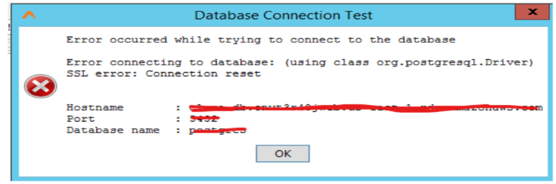

Issue Description:
The client has enabled SSL on their postgresql RDS database; however, they are encountering issues when attempting to connect through AutomationEdge Process Studio.
Warning
Error Message:
Error connecting to database: (using class org.postgresql.Driver)
SSL error:connection reset

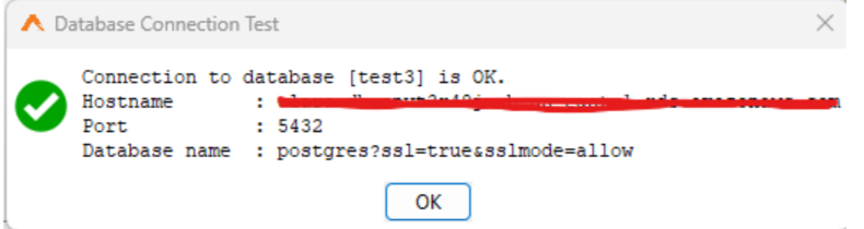

Root Cause:
 when connecting to database using SSL, we must add sslmode=allow in the connection string or along with the database name in database plugin steps like table input, Call DB Procedure/Function, Insert/Update, and Java class, etc., as below.
Idea
Recommended Solution:
Here are the options that we can use along with the database name:
Idea
Method 1:
A. postgres?sslmode=allow
B. postgres?ssl=true&sslmode=allow
C. postgres?ssl=true&sslmode=allow&sslrootcert=E:\\global-bundle.pem
Idea
Method 2:
You can also use “Connection String” option where the entire string can be mentioned as
Connection string sample: jdbc:postgresql://<Host>:<Port>/<DB Name>?sslmode=allow
Idea
Method 3:

After adding this we were able to test the connection successfully.
